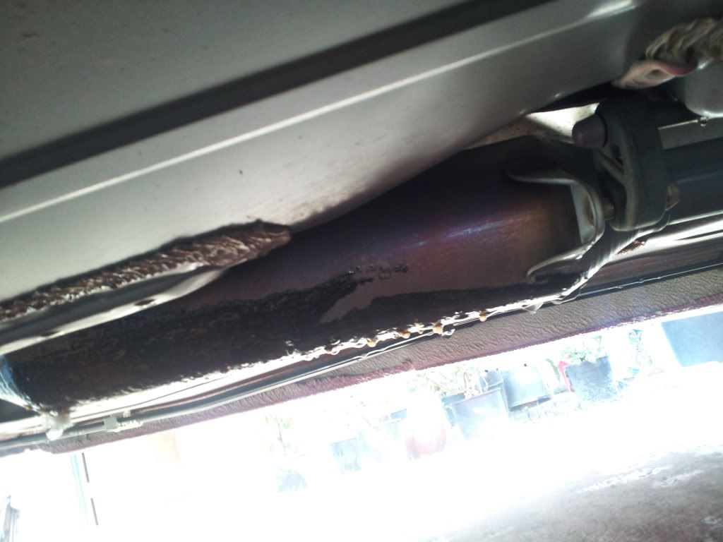

so my gf drove over what looks o have been a plastic bag and the heat of the exhaust got it stuck on the piping. now almost the whole cat back has plastic melted onto it and after driving for more than 15 minutes it smells. now what would be the easiest way of getting it off?. i know i can try scrapping it off little by little but it would take way too long. any suggestions?
hard to get a good picture of the plastic on there

You have to scrape it of while it's warm man. PITA!

lol that happened to me to , i hope you like the smell of plastic for a few weeks , i just used a drill and wire wheel while it was warm

easiest thing: deal with the smell, it will go away

Get that exhaust nice and hot then use a steel putty knife to scrape it off. Make sure you wear some gloves/mitts when handling that exhaust though. Or like danimal86 said, just deal with it. It will eventually melt away.

tried to scrape it off warm but it was a pain so i left it :lol:

Maybe lift it and spray with a power wash?? Just throwing ideas out there

Yeah, if you don't wanna scrape, just deal with the smell. It will eventually burn completely off. Take a nice drive up/down the coast on a hot day, that should take care of most of it ;)

Drive that b**** hard and it will burn right off.s*** will get real hot after wot for awhile.otherwise some diesel might take it right off. I melted sOme plastic on my dads Harley exhaust pipe and it came right off with a little rub down with diesel.of course it would be advisable to do that when the pipes cold lol

don't know if this will work, but freeze it to make it brittle... start at the edges and work your way in breaking off chunks.
spray it with that air in a can stuff held upside down.

How about trying a heat gun?

i scrapped most off then drove to six flags (about 100 miles) in 90degree weather and most of the smell is gone now .
