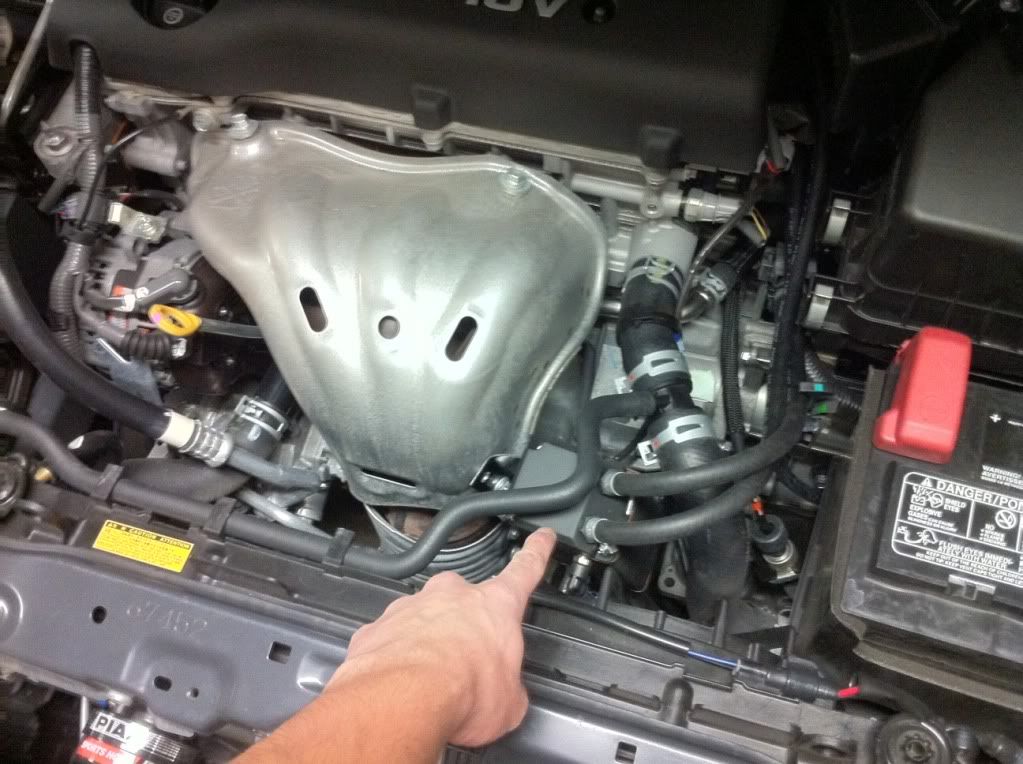

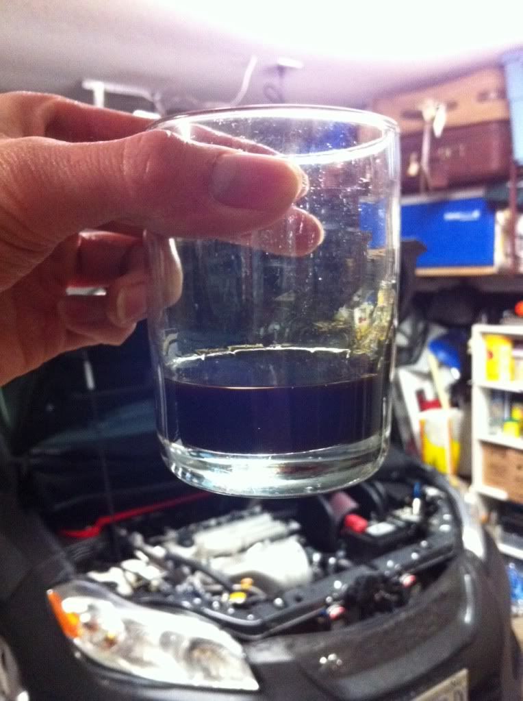

Installed this ebay catch can 8000km ago. Put steel wool inside and fabricated a down pipe for the inlet tube inside. 8000km later, check out all the blow-by...only after 8k!!

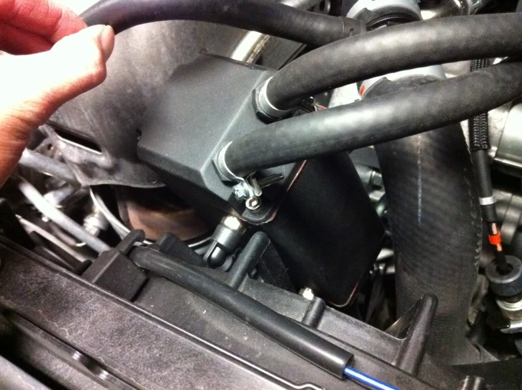

#7 groove9028
  • 105 posts
Posted 26 February 2012 - 11:04 PM
It was one of these,
http://www.ebay.com/...#ht_2267wt_1054
I just stripped the cheesy paint off, scuffed it, then painted it with a couple of coats of hi-temp tremclad black. Then replaced the barbs with standard 3/8 brass fittings from home depot.
Then I fabricated my down tube and sealed the barbs off with some JB weld.
I also had to make my own mount to fit in such a tight space. It's mounted on the lower bolt of the heat shield.

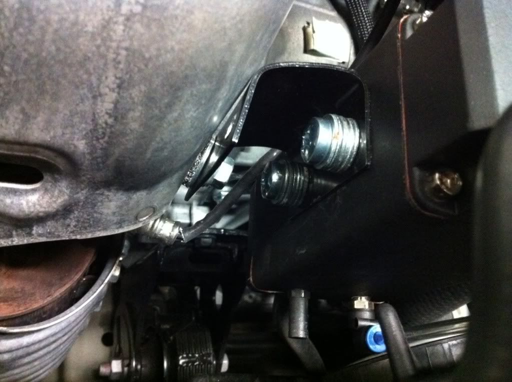

Posted 27 February 2012 - 07:25 PM
Are those drain hole son the bottom? What could I use to plug those holes?

#10 groove9028
  • 105 posts
Posted 27 February 2012 - 09:17 PM
There's only one hole to drain from on the side. The rest of the holes are for the fluid level sight. I ended up buying a bolt to replace the one that came with the can. I just picked it up from home depot.
