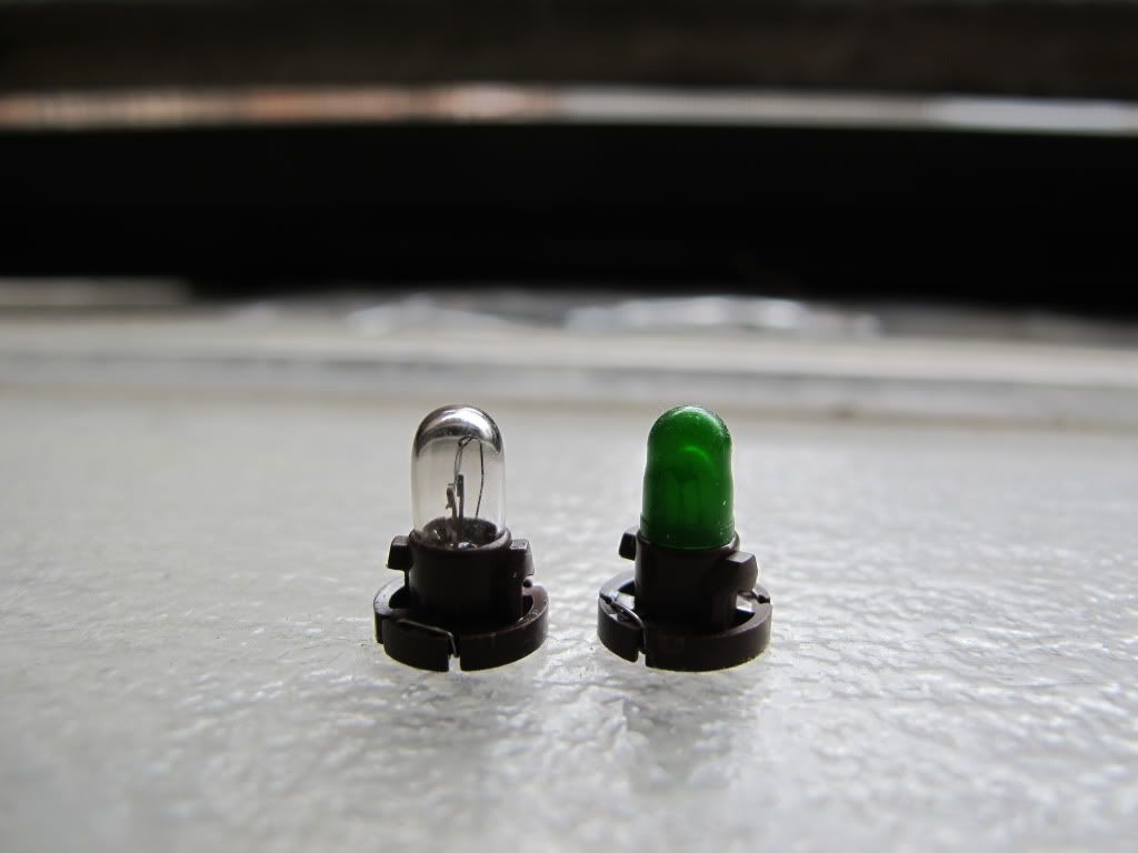

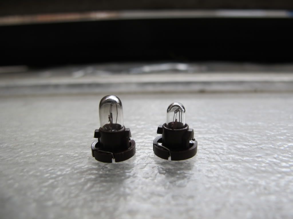

If anyone is trying this, you need to also remove the radio and reach over from the top.
Put some tape on the outside of the lamp holes and put the bulb through from the back. Don't drop it! Hope the tape will hold it in place. Then get your small screw driver and carefully screw it into place.
Another member recommended the 84999-10090 bulb. This is the correct bulb and it's the same size as the original but I used the 90011-01019 bulb instead. The housing is the same, but the bulb is smaller and also cheaper.
84999-10090 is $10 while 90011-01019 only costed me $5.
84999-10090 (left) 90011-01019 (right)
