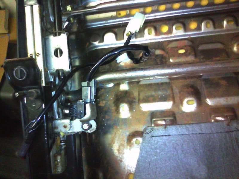

well i have some picz and a video on how to do it ..... pretty simple 15min process
you'll need:
small or thin flat head screwdriver
4 wire ties
a drill
1/4'' drill bit
or and hex key kit

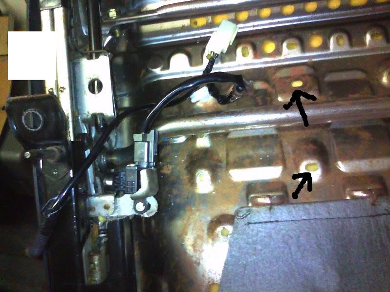

1. flip old seat around to u see the bottom side
2. remove the clips from there locations u could brake them but if u plan on putting it back take your time.......
3. after that side the harness towards the buckle then under the center bar its tricky but i will go throw.....

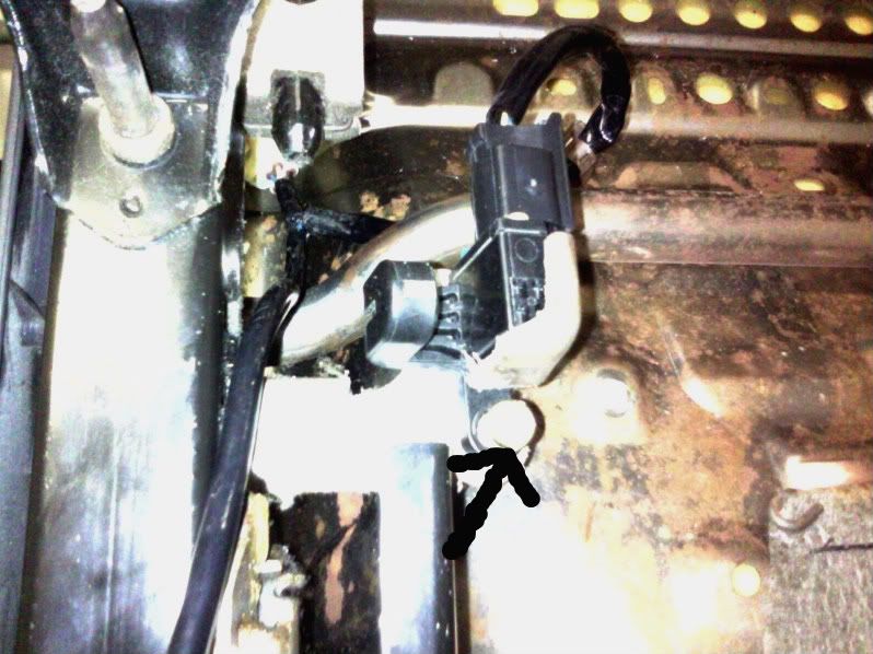

4.then the hard part try with a hex key set first to remove this bolt if not drill it out (i drilled)

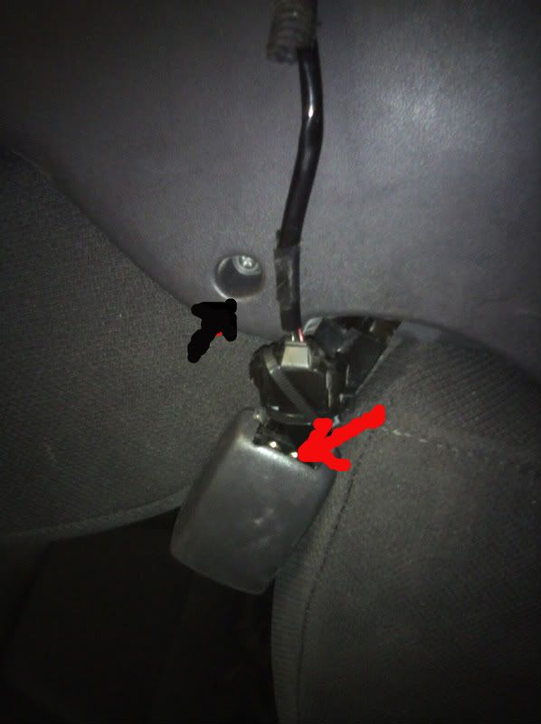

5.after that it will side out towars the front no u might have to remove the side panel screws to move the harness throw the side where the buckle is.
6. the black arrow shows the screw on the side panel and there should be one on the rear.. the red arrow is where u will stick the screwdrive in and just pull out and the clip will just come out. with no troubles

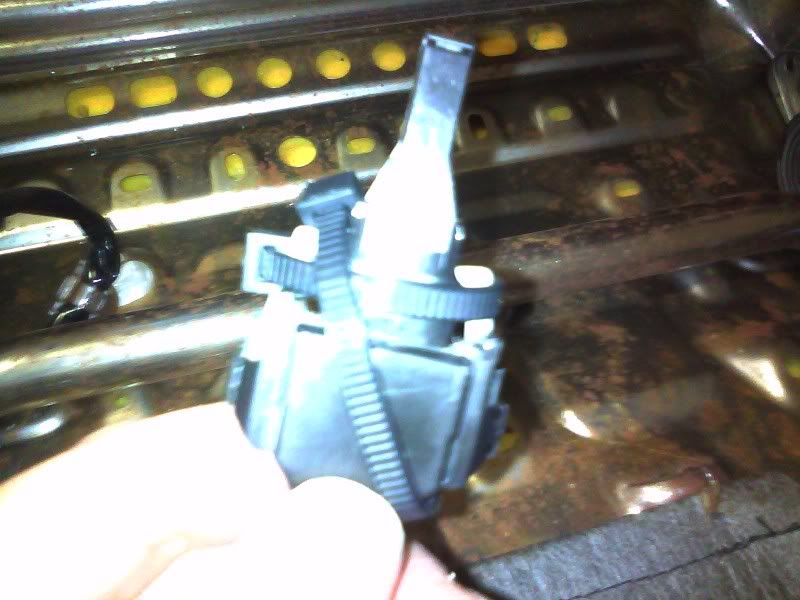

7. wire tie the two white sides of the clip. then on around it holding them down in a cross with the wire ties
8. plug it in your car use the other two wire to hold everything to gether and start the car give it about a min or too and the light will go out
