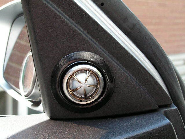

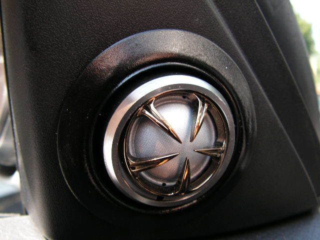

Posted 25 August 2008 - 11:17 AM
Tweet - Tweet - so sweet:

Posted 25 August 2008 - 02:47 PM
Nice Frank. What make are they and did you use a crossover and did you replace the 6.5's too?

Posted 26 August 2008 - 01:47 AM
Speaker setup is from Clarion (Model is SRS1686). They come complete with the 6 1/2 speakers, tweeters and cross-overs. I wanted to maintain the factory look and not go oversized.
Normally you would want to buy the whole setup in order to achieve a flatter response for the entire frequency range. This could also be done via an equilizer (and some good ears).
Clarion SRS1686
You connected to the wire from the door speaker ? I want to do this a while now but haven't gather enough info.

Posted 26 August 2008 - 04:03 AM
Quote
The existing door speaker wires connect to the input of the cross over. On the output side of the cross over, two wires go to the tweeter, another two go back to the door speakers.
