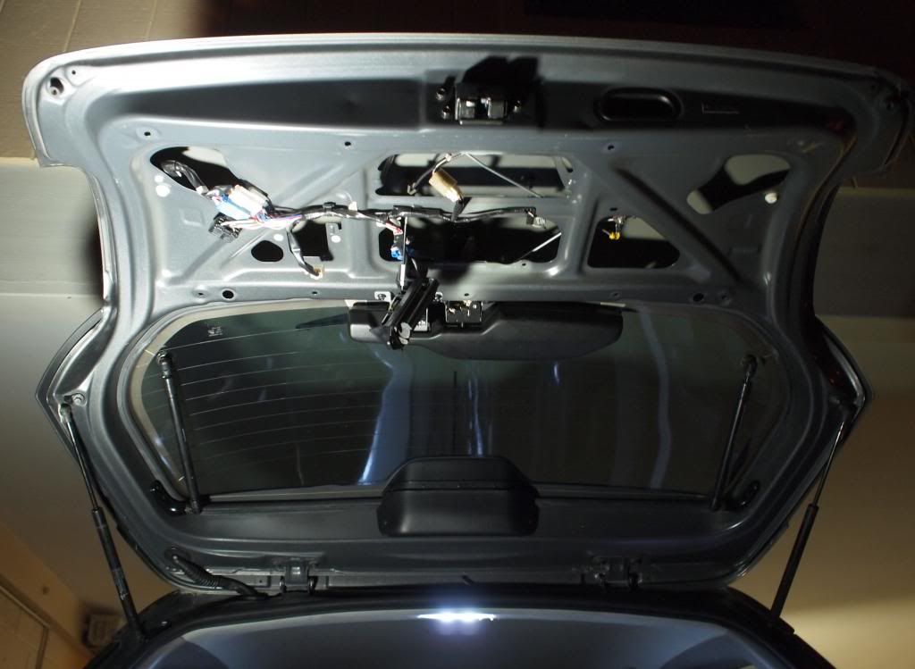

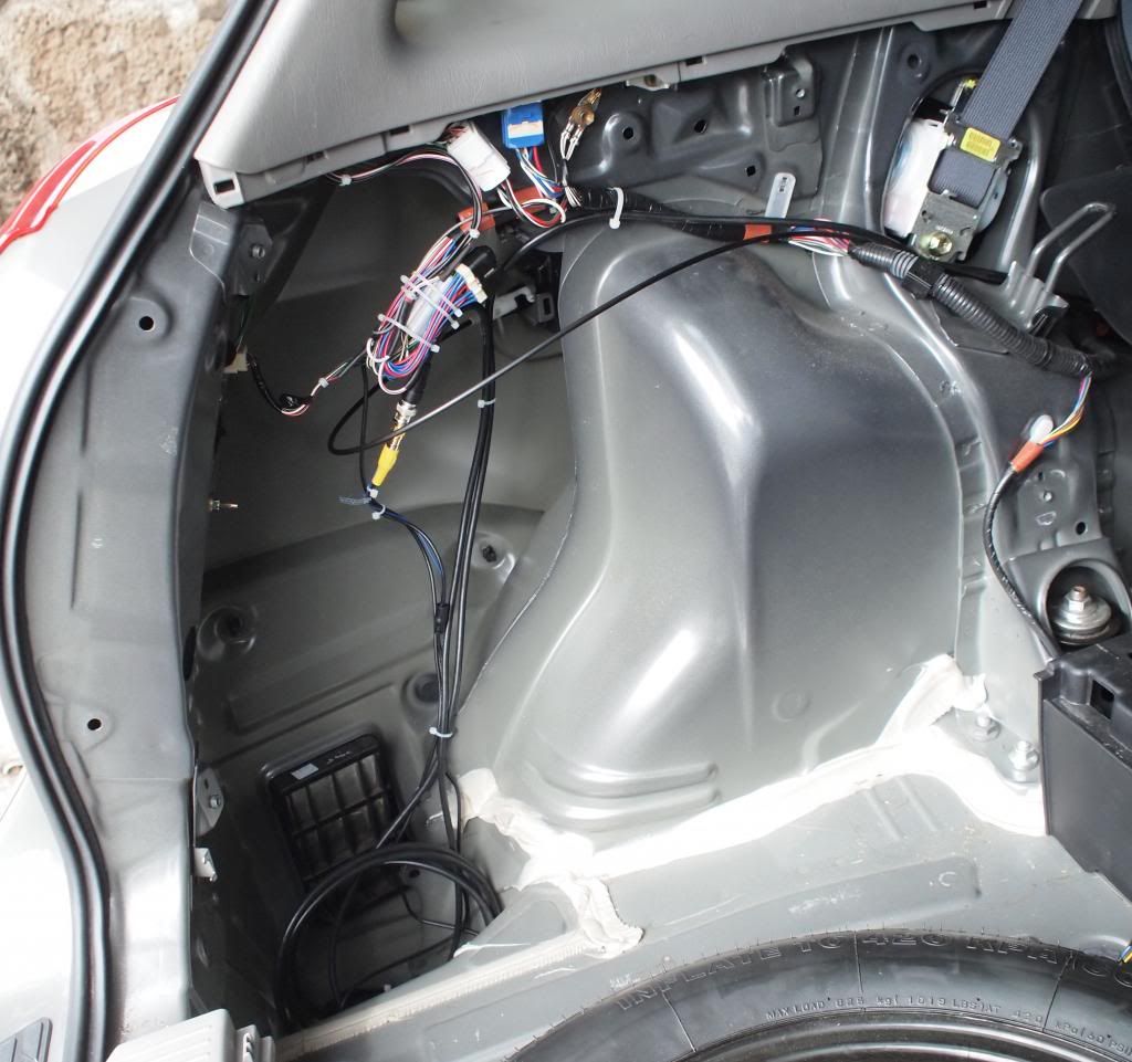

1. Open the glass portion of the rear hatch.
2. With a Flat Head Screwdriver gently pry open the plastic casing surrounding the rear wiper bracket. Work your way around the casing releasing all the clips. Note: Be careful not to break the clips.
3. Remove the two 10mm nuts and remove the wire harness from the studs. (See pic below)
4. Remove the three Phillips Head Screws. (See pic below)
5. Remove the 10mm bolt that secures the rear glass handle and the 10mm nut that holds the rear wiper bracket in place.
Note: Be sure to support the rear wiper bracket. A second set of hands are useful here. (See pic below)
6. Turn the Wiper Bracket over and unclip the plastic wire retainer.
7. Insert the new Wiper Bracket (with Rear Wiper Motor) by securing the bracket with the 3 Phillips Head Screws removed in Step 4.
8. Replace the wire harness removed in Step 3 and the 10mm nut removed in Step 5. Note: Be careful not too torque these too tightly because you can crack the glass.
9. Connect the Wiper Motor to the wire harness and clip the wire retainer back into place. (See pic below)
10. Replace the cover and close the glass portion of the hatch.
11. With the glass portion closed assemble the wiper assembly as pictured in the parts diagram (located in the Parts List of this How To) and you’re done.
12. The only thing left to do will be to install a Rear Wiper Relay and a Wiper Switch (w/ rear wiper).
For a How To on installing the Rear Wiper Relay see (Mod Please Insert link from my other How To)
For a How To on installing a Rear Wiper Switch see (Mod please insert link from my other How To)

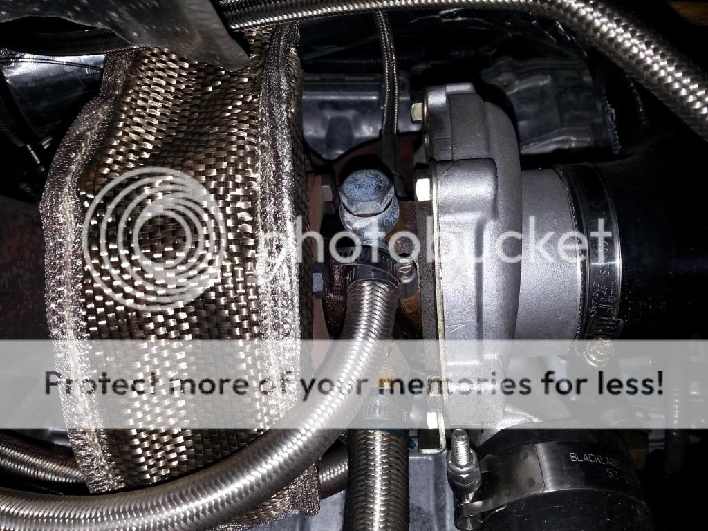

Step 1: Pop hood and locate the 2, 10mm nuts holding the engine cover. Remove the nuts and pull up frimly to release the 2 pop nuts @ the back of the cover. Set aside neatly. Unplug the first 02 sensor before continuing.
Step 2: Take anti-seize spray and spray the 4, 12mm bolts for the exhaust heat shield. Let sit for 10-15 mins. Come back and remove the 4 bolts carefully! The top 2 should be simple, but the lower 2 are probably rusted and will round very easily. If you round the head of one, you'll need to use vice grips, a grabber bit or even a grinder, (like I had to with one of mine, lol). You can always buy a replacement bolt, but the heat shield can survive on 3 bolts. Carefully feed the 02 sensor cord through the heat shield opening. Once removed, set aside neatly. (Pic of heat shield & bolts)
Step 3: Take anti-seize spray and spray down 5, 12mm head bolts that hold manifold, 2, 14mm spring bolts that hold ball joint assembly, (manifold to cat) and 3, 14mm bolts that hold manifold stay bracket under the manifold, (if desired). Let sit for awhile, the longer the better. Go eat, have a couple of beers, take a nap, whatever, just let them sit to soak in the spray.
Step 4: Come back and carefully remove the 5, 12mm head bolts with socket wrench. Don't apply too much pressure as you don't want to snap a head stud. If you do, it's a b!tch to repair and probably will require drilling, tapping, etc. Take the 5 nuts and carefully set aside where you won't lose them.
Step 5: Jack up front end of car as high as it'll go. If you have access to a hoist, use it! For the other 98% of you, jack it up and use the jack stands! I'm not responsible if you get crushed, lol.
Step 6: Get under car and with breaker bar, (or 1/2 drive socket wrench) and remove the 2, 14mm spring assy bolts. These are the hardest to remove and will require a deep socket, extension and probably the breaker bar for leverage. Set aside bolts with springs. (pic of ball joint assy)
You can see the extension going up the left of the cat and the other bolt is to the upper right.
Step 7: Remove either the 2, 14mm stay bracket bolts or the 1, 14mm pivot bolt on the stay bracket. The 2 bolts are easier to remove, but pulling the manifold out with the full bracket is more difficult. The choice is yours. At this point, the manifold should be free. Set aside bolts. (see pic)
Step 8: Pump up jack to free the jack stands and lower vehicle back down. Carefully free manifold away from engine and remove EM gasket. Inspect gasket for damage. It's a 2 plated metal gasket and as long as it's kink-free and both plates are still attached, it can be reused. You can gently wipe away any residue with a soft cloth. Set gasket aside gently until install time.
Step 9: Carefully feed the EM up between the engine & firewall. This is somewhat difficult but not impossible. Take your time and don't get frustrated as you don't want to damage any fuel lines, etc. on the firewall. Once out, you can proceed right away to step 10. Leave the stay bracket, 02 sensor and lower heat shield attached, if desired.
Step 10: It's time to drill and weld in your wideband bung. My suggestion is to call ahead to a exhaust shop that you trust and set up an appointment with them first. If you have a good drill & welder, (and know what you're doing) you can attempt this yourself. The manifold is double walled and is difficult to drill, you may need to machine the top layer after drilling to properly drill the 2nd layer. The bung should go 1-2 inches down stream from the narrowband 02 sensor, not before it! You can keep the narrowband in during drilling/welding but cover it/tape it up before welding to avoid it getting damaged.
Here's an after pic of the completed EM, ready for install:
To re-install, work your way backwards through the steps, starting with feeding the EM back into place and getting it into position. Don't forget your EM gasket!!!
Torque specs:
Exhaust Manifold head nuts ~ 27 ft. lbs
Spring Assy bolts ~ 32 ft. lbs
Manifold stay bracket ~ 37 ft. lbs
Pivot bolt ~ 30ish or hand tight (couldn't find actual spec)
Heat shield bolts ~ 9 ft. lbs (or snugged up as 9 ft. lbs is hard to measure)
I suggest installing the wideband 02 sensor BEFORE putting EM back in as it's difficult to get it afterwards.
If you are re-installing the heat shield, you'll need to cut out a section for the wideband. Use a cutting wheel/grinder, (use safety glasses please) or hella strong tin snips. This heat shield is double layered. Here's what mine looked like:
Completed install pic:
Hope this helps someone, as I had to learn this first hand, with the help of the local MO community... (you know who you are ;) )
Cheers!
